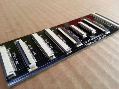

Hello, sorry for my non russian speak.
I want to know if there is some case where keyboard converter module is necessary?
Thanks in advance.

gelang
If we are talking about BIG_KB_TEST ....
It is needed if the FFC of the keyboard contains more than 32 contacts. If there are less than 32 contacts, then the programmer will be enough.

Yes, happy to know his name. Is it BIG_KB_TEST we see here?
useless in this case i believe cause gl553vd has 17 pins connector.
Thanks a lot sir Vertyanov, i'll contact you for purchase.

gelang
*** Переходная плата с разьемами на борту CONN_MIX32 600р КАРТИНКА
